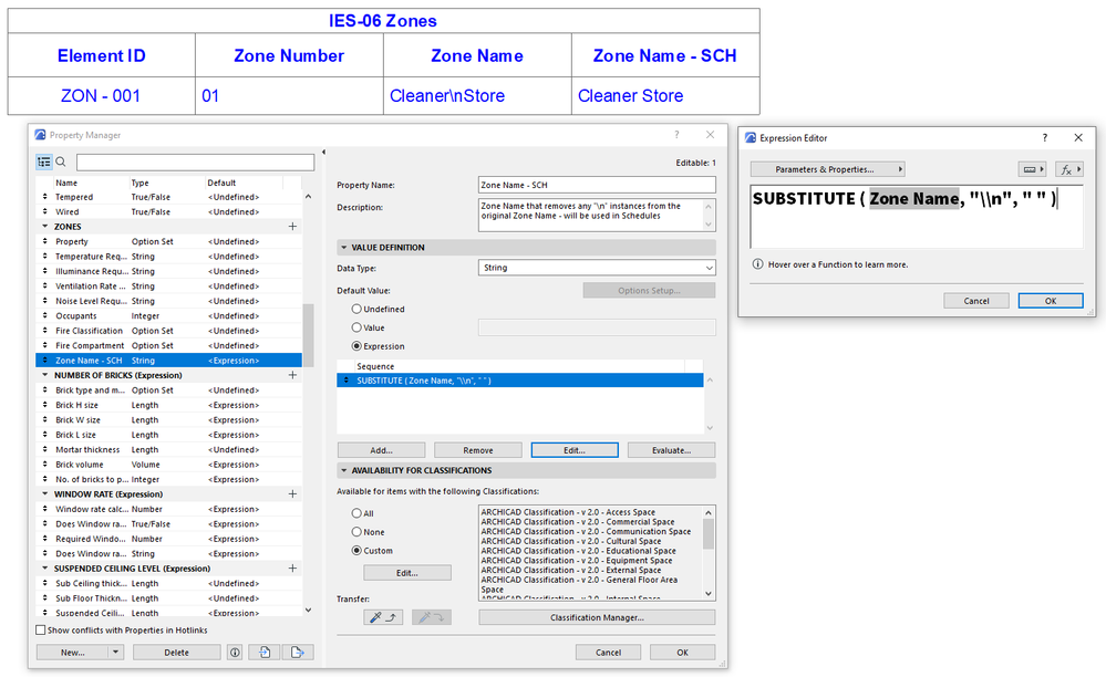

What I think Christophe means is that you could go to the Property Manager Dialog and you could create a new Property for your Zone. This Property would be used for scheduling purposes, not the Zone Name.  The Property would be defined by an Expression, in which you take the Zone Name and substitute the "\n" text within it with a SPACE character.
The below screenshot shows the exact Expression to use and the result in a Schedule.
One thing I found:
In the SUBSTITUTE command, I had to write "\\n" instead of "\n" because in the case of the latter it did not consider the "\" character.
Probably writing \\ is the way to explicitly tell the Expression Editor that you really meant the \ character. 

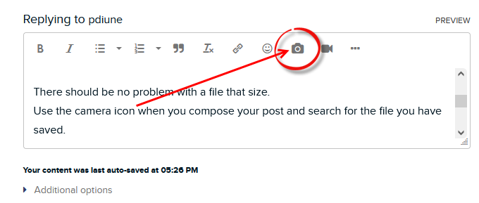

There should be no problem attaching images.
Save your image file and then attach with the camera (image) icon when you compose your message.
I also discovered if you use a screen capture program, you can just capture the image to your clipboard and paste it in the reply.
