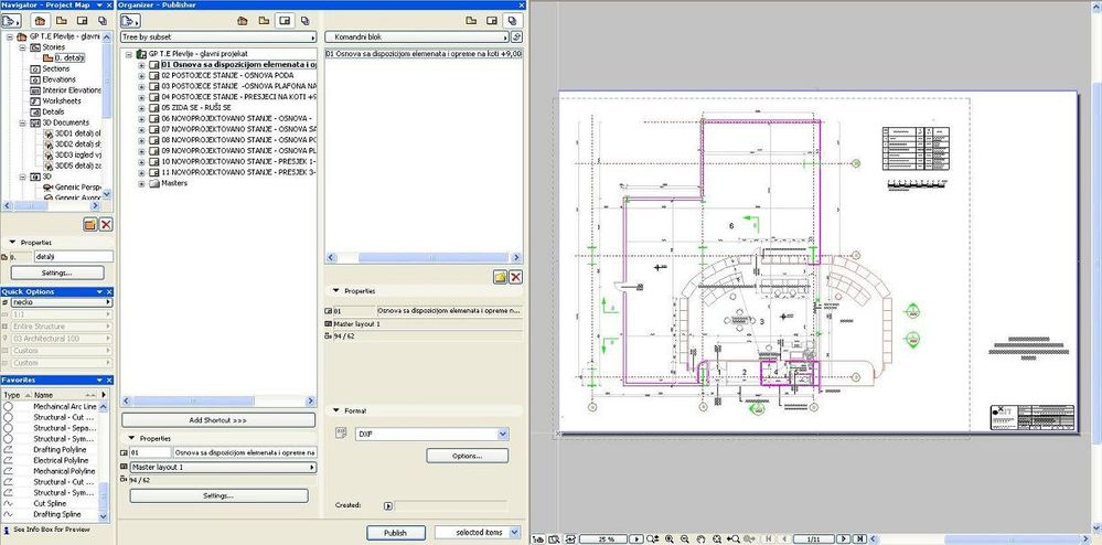

I prepared some drawing for prinitng and i ned to save one of them as DWG to sent to my friend to check it out. I have next problem and i never had it before !
If i select PDF as output i get what i want
If i select DWG as uotput i get problems (I dont get what i want, layout is not saved, insted of that PLAN of model is saved....Wierd . . .can any1 produce this.
archicad 13 32 bit !

pic2
this is PDF output and this is what i want to get when i select DWG but its not working,. ., .
Pic 3
This is what i get when i select Dwg fromat ...
am i doing something wrong ???
my error, i got it
It was cos i had wrong option selected in DXF-DEG traslator
It must be selected
Save layout into : MODEL SPACE
