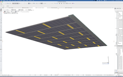

Did you try the curtain wall tool ? It's really the best tool to do what you want.
The example below is not finished because I have used simple profiles and panels but it will be easy to replace them with the real ones and add the suspensions as jonction elements when needed. I had first to quickly create photorealist images.
