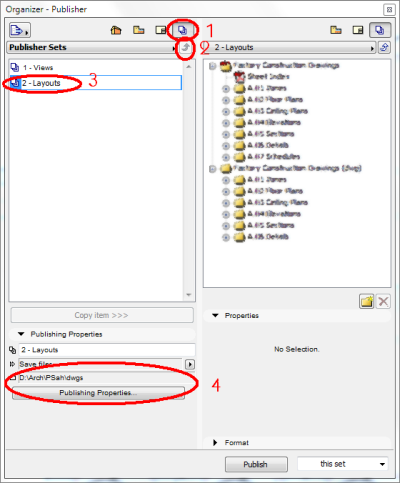

When I first publish a set of PDFs of the layout book AC asks me for a location to publish these PDF files to. I want to be able to change this location, can anybody help?

In the top right corner of the Navigator/Organizer there's an up arrow that takes you up a level to show you all your publisher sets.
From there you can edit the publishing properties using the button at the bottom of the Navigator/Organizer, including the path to where it publishes.

Open the Organizer and
1. Go to Publisher Sets
2. If necessary, go up a level
3. Click on the layouts or views for which you want to change the path
4. Click on Publishing Properties
Hope this helps.

Link is right. You can do the same thing directly in the Navigator too. For some reason (don't know why) I've always done it in the Organizer.

Thanks. That's perfect, this has been plaguing my publishing for too long and now 'tis resolved!
