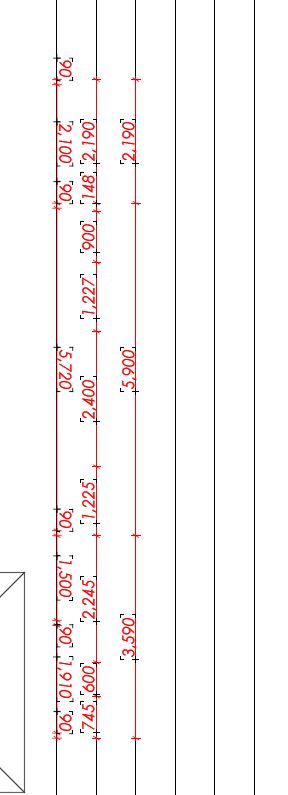

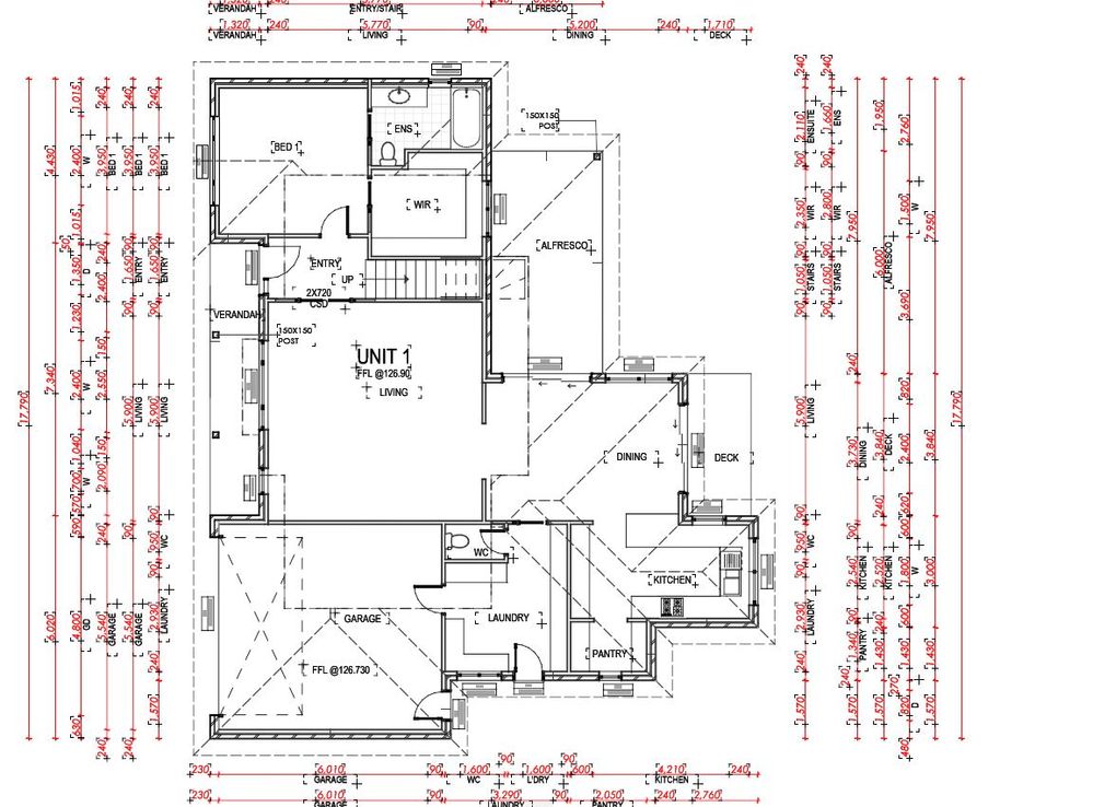

My first line of dimension text is coming in wront orientation other lines are correct. Looks like when doing the internal wall dimensions text orientation is coming wrong. How to make all in the same orientation. please see attached snip

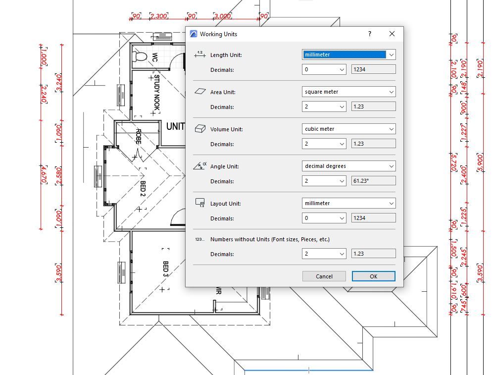

One thing to check is the angle of the dimension string, if it is not exactly 90˚ this can occur. You may need to turn on Working Units > Angle Unit > Decimals to see the exact angle.

Thanks for your reply. I couldn't find an option to change the angle of dimension string on working units> angle unit>Decimals.  see attached snips.
Also my ground floor storey all dimensions are coming on the correct orientation. This problem is on the first floor level

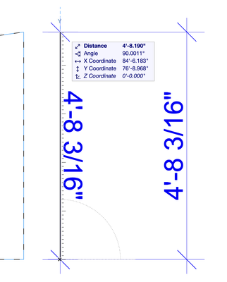

My suggestion about the Working Units is so you can accurately check, using the Measure command, the angle of the dimension string. If it is a bit off of 90˚ the dimension text will flip over the line.
