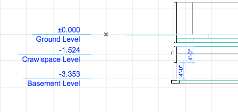

can anyone tell me why my elevation values look like in metric whereas my dimensions are in imperial? how can i change it to imperial ? I've checked my preferences and they are in imperial...

In Project Preferences, there are 2 different things
1. Woking units
2. Dimensions and others
Have you checked both (all of them) ?

Thanks...where is the working units setting?

i have checked both and they are both in imperial..... i have to redraw again the mesh and elevations...i think this is the 25 th times!

can you attach your working file ? (instead of the image)

Check Project Preferences > Dimensions > the 5th button from the left.
