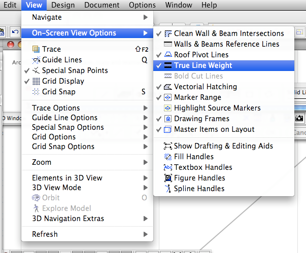

have you show the line weight view?

Yes I turned all the option True Lineweight. I can get control of Wall Pencolor (therefore, lineweight) in elevation. However I can't get control of curtain wall(window) pencolor (lineweight) in elevation. Do you know how to manipulate it ?
As for the Marked Distant Area, it works in its way, but still I can't get control/modify of the pencolor (lineweight). Maybe I'm missing something.
Thanks in advance for your help.

tranthainguyen wrote:
However I can't get control of curtain wall(window) pencolor (lineweight) in elevation. Do you know how to manipulate it?
Set Uncut line pens to the desired colour.
