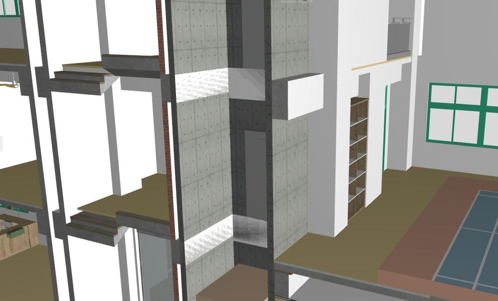

hi,
i have a problem on section showing priority, when the elevator(object) connection with beam on section, is there any way i can set the beam section to the front?
I have try change intersection priority on architecture material and also try changing layer prevent intersections but useless,
will be very thanks for the answer.

Thanks for the reply .
I've try adjusting display order already but still doesn't work ,
Maybe I am making the model in the wrong way , I shouldn't let the materials overlapping each other.
Maybe the only way to solve my situation is to make the beam  thinner ....

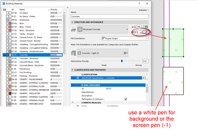

The background fill used in the beam Building Material may have an 'empty' (null) pen (0).
If it does change it for a white pen or the screen pen (-1).
You may also have to bring the beam forward in display order as well as sent the elevator object backwards.
