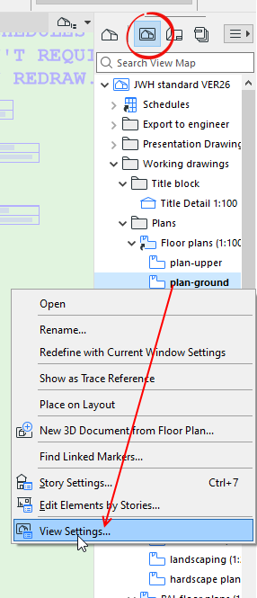

I am not sure if this will help.
When I open my template and open a particular floor plan view, it automatically shows with an exclamation mark in the tab - it really shouldn't.
Double clicking the tab does not clear the exclamation mark as it should do.
If I select that view in the view map and open the view settings and then just press OK, it clears the exclamation mark.
Now if I change any settings, I can double click the tab to set back to what it should be.
Make sure that none of the view settings are 'Custom' - except for the name or ID.
