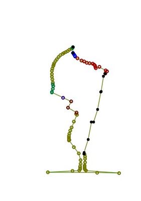

Is there as way to fill a polyline shape that has already been created?

Yes, the french user Yves created a polyline accessory for this: https://community.graphisoft.com/t5/Modeling/Any-tip-as-how-to-create-multiple-slabs-in-one-go/m-p/5...

Use the Magic Wand
AC4.5-AC29 AUT, GER, INT www.a-null.com
The solution of Bernhard Binder works best if you only have a few closed polylines to fill.
