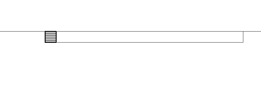

in this section i made a pergola with beams but i can see the wood fill only in the cutting elements..what i am missing?

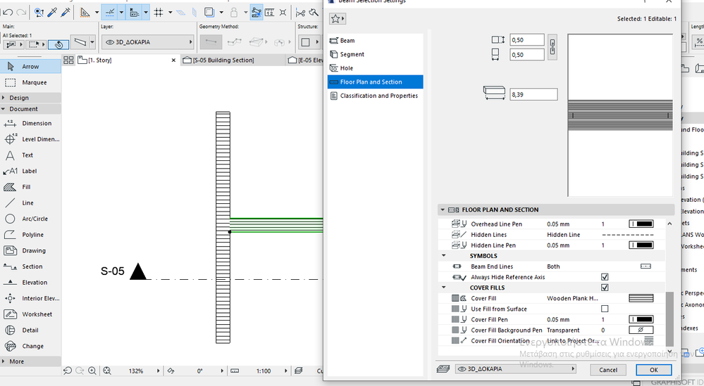

Have you applied a cover fill to the beam (assuming you have used a beam for the horizontal elements). There will be a tick box in the properties of the beam where you can switch it on and define the fill to use for the cover fill.

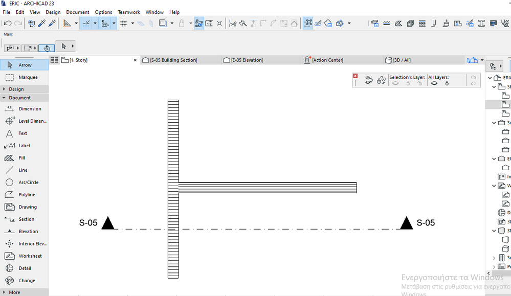

here are some printscreens of what i have done...

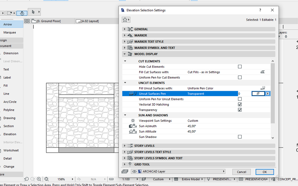

Check the Uncut Elements settings in the Elevation Settings Dialog. Is the "Surface - Cover Fill Foreground" option checked?

Try changing the "Fill Uncut Surfaces with" field to an option that displays the Fills.
