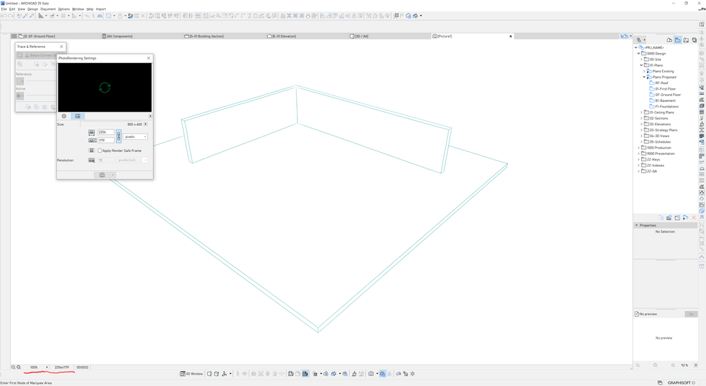

I've upgraded to a 4k monitor and have some questions
1.  The UI is mixed.  2D and 3D display of the model is great and lines are thin and crisp.  Icons and some UI text is a bit blurry - is there a setting to fix this or is that a current limitation?  It's usable but not 4k sharp
2.  When setting render resolution and viewing renders, the resolution numbers aren't right.  If I bring up the PhotoRendering Settings window and set the size to "Size to 3D window", resolution is set to 2256x1179, when it should be 3384x1769.  This has something to do with the 150% system scaling I have set in Windows settings
Similar thing if I view the 2256x1179 render in AC it fits the 3D window and indicates 100% size but if I copy and paste the image into PS it displays correctly at the smaller size
3.  Isn't there a dark mode in AC25?

I posted to highlight the points in my OP that there is a bug, or an error, in the determination of the 3d window and render window pixel count, and that some of the icons and text is a bit fuzzy
Graphisoft can fix it or not.  If they don't I have a workaround that I've added to the many other workarounds
