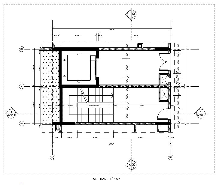

how can I rotate the Text in Grid ?
Please see attached. I wanna rotate the text (A,B,C or 1,2,3) in Grid in layout to align with the vertical as is in the attached file.
Does anyone know how to do it ?
Please advise
Thanks so much

You will have to save a custom copy and amend the Text so it gives you the option for all the text to be horizontal.
You might look at the door markers to see how they do it, or a kind soul here might post one
p.s. I think you should also make this a wish.

Did you check the settings of the Grid Marker object (NOT the Grid System)?
