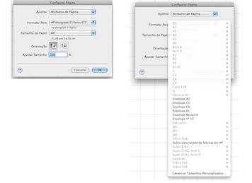

I have a problem in archicad v.13
My printer is an HP DesignJet 110 and when I try to change the size A4 to A1, the options are impossible to select.
I upgraded the drivers but nothing works.
Here is some shots to ilustrate the problem
Thanks for the help.

What HP driver version are you using?
I've got 4.4.2 w/ no problem selecting A1.

Actually I have a similar problem with the designjet 110. I can not print custom size paper. The print window says that this sizes are not supported. The 110 has been a real pain so far.

Actually,.. I've had " Paper Size Error" problems when printing from "Publisher".
I resolved them by resetting "Page Setup.." and "Print Options.." in the "Format" window.

Is not working. I realized it does not work from other applications also. So, AC cannot be blamed. the last drivers where also installed and did not change anything. The "page setup" window still does not let me select custom size papers. They are grayed out.
I have tried to print also from an imac with 10.5 MacOs and got the same results. So, really no idea where I should look to find the problem.

Back to the original post.... If you set the "Format For" pulldown to "Any Printer"... you should be able to select any paper size.
