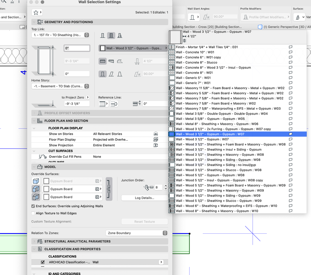

i cannot use the wall end tool - what is the syntax for using it?
proto
for the life of me, I cannot use the wall end tool
i just want to cap the end of a simple drywall partition [3.5" stud + 1/2" drywall both sides]
what is the correct way to use this tool?
the cursor doesn't seem to react to the end of the wall at all
mac ACv27/6000, US full, Sequoia 15.1.1, 2020 iMac/2023 MacBook Pro

You need to click exactly on the outside corners or the end of the base / reference line for the wall end to work.
You cannot add a wall end to a wall on a locked layer.
I know this doesn't apply in your case, but for the benefit of others, you cannot add a wall end to a COMPLEX profile.

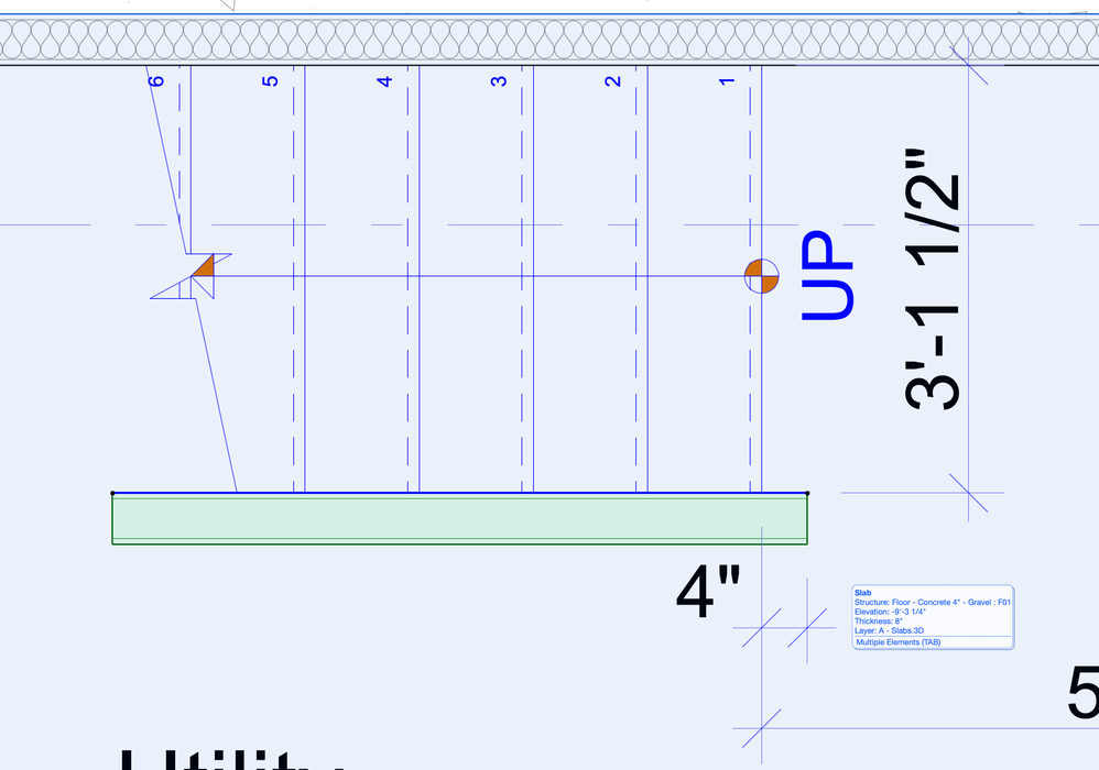

To add to this, I want to shape the wall as its bottom edge wants to follow the bottom edge of the stair as it rises. Hopefully, SEO operation doesn't affect the wall end cap condition...

i'm not able to replicate that
i have tried on several walls placed out into space to isolate them. i've messed with the settings.
it's as if there's a persistent setting that is preventing this operation
