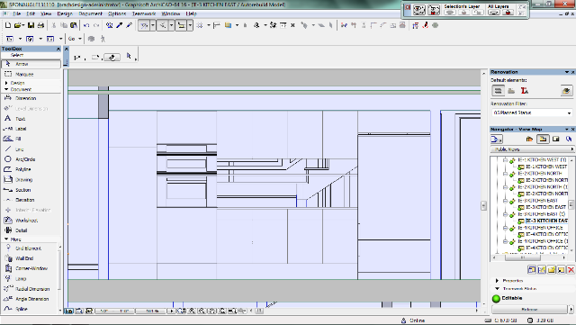

my interior elevation is looking at a wall and seeing right through it, showing the stair on the other side. In another case a door is showing up that is in wall that is perpendicular to the wall I am looking at, on the other side of the wall in the next room. Any ideas?

Dave Brach
Here is a screenshot showing the door showing. It is about 4 feet away on the other side of the wall.

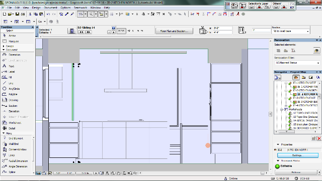

Dave:
On item to check in the Interior Elevations settings: Model Display > Exclude View Blocking Walls.

I tried the "exclude view blocking walls" toggle, but can't really figure out what that does. Funny thing is, It never occurred to me to just use the "regular" elevation tool. From now on I'll just do that instead.
From the Help files:
Exclude View Blocking Walls: Check this box if you do not want intervening walls to be displayed in your Interior Elevation viewpoint.
So any walls inside the boundary will not be shown.
