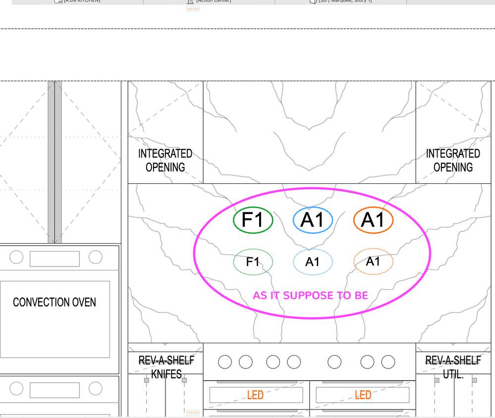

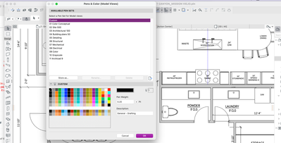

I have a constant issues with pens setting .
1. I created own pens setting , probably 10 times during one project .... but after while the old setting loads automatically back to old setting , and I have to set up again (???). I made sure I saved project after each time. its annoying.

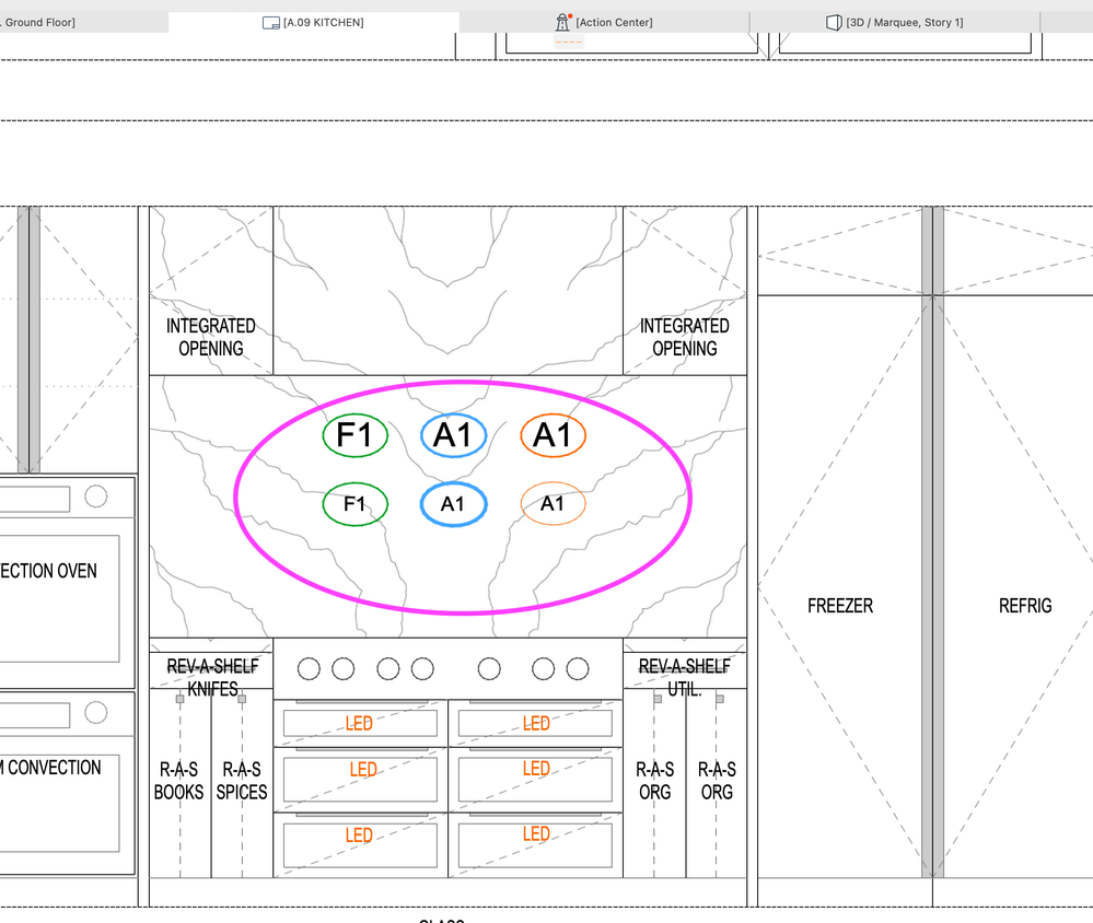

2. Even after setting up pens thickness when it works, in drawings it show correctly but then in layout it shows the pens are in different thicknesses.
Please helpppp. Why there is aways something that I spend hours on fixing unsuccessfully instead of having fast flow :(((

Never use a 'Custom' pen set.
Always 'Store As' to one of the existing pen sets, or you can create a new one.
Then when you use that particular pen set, you know you will always have the changes you have made.

Make sure you are saving your pens sets as mentioned - you do not ant 'Custom'.
Apply the pen set to the View settings.
That View is then placed on the layout as a 'drawing' so it will remember the pen set used.
However check the drawing settings to make sure it is using the views pen set and not another pen set.
It is possible to override the pen set used by the view in the drawing settings.

The way I save pen setting is basically ... Menu > Pen & color (Model views) > custom > I select colors, thicknesses > click on "ok" (there is no other option).
If this is not the setting to actually set up Pen & colors... then I don't know what it should be.
