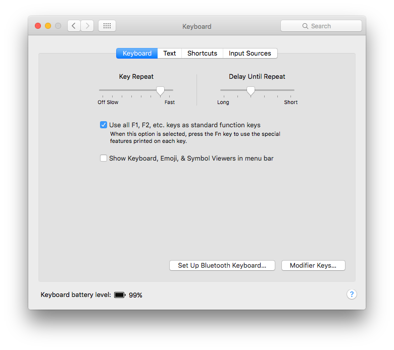

Brad Elliott
Make your life easier. Go to System Prefs/Keyboard and check use all function keys as standard.
