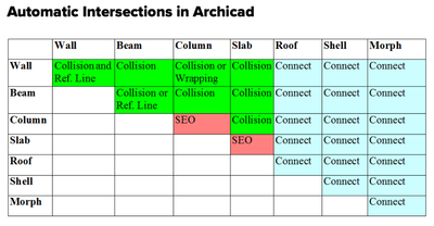

This graph (found here), which has not been updated since the introduction of building materials in Archicad 17, should be an embarrassment to Graphisoft. I know I am embarrassed when training new users. Mesh is not even listed. And some things don't work as advertised, like stacked walls. The sheer number of workarounds required to get acceptable connections across the average model is staggering. Graphisoft created a brilliant system based on sound logic, but never bothered to extend it to all elements, or add the needed manual overrides. This despite the fact our computers are many times more powerful now and could handle the required computations.
Fixing this should be development priority #1.
