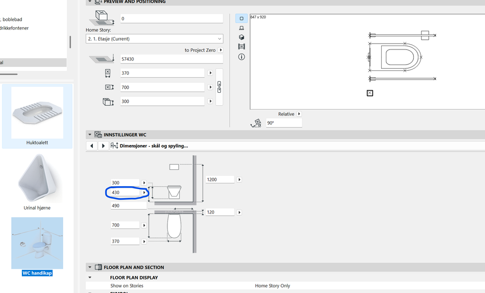

Hello,
I am wondering how can i get a Library part parameter from a HC Toalett onto my custom label?
I need precisely this measuerment which is the BOLWHeight.
I tried to tweak a label but it didnt go so well. I also tried to make a custom property witht he expression editor but it didnt go either.

You can write parameter values ​​to properties using an addon. Or write your own label that will use the ASSOCLP_PARVALUE function. There is an example of such an label, but it does not have an English interface.
