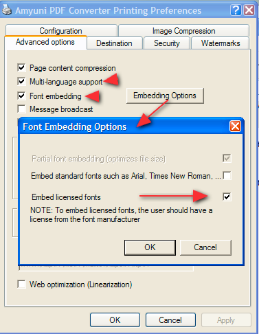

I don't have AC 12 on my Windows VM to test - but at least with the Amyuni driver for earlier versions, you had to embed licensed fonts (such as the one you use) - and I also notice that certain punctuation does not get saved unless I also check 'Multi-language support'. See attached screenshot.
Karl

I am not sure to understand what to do about the Amyuni driver. How do you get this dialog box? It seems from your screenshot that it is a virtual printer, but I can't see it under Start --> Settings --> Printer.

My recollection is that 12 does not use the Amyuni PDF virtual printer any longer on Windows. (That is the screenshot I showed.) I'm not sure where the PDF settings are now. Apparently there was an issue with ArchiCAD 11 that was addressed by a registry setting:
http://www.archicadwiki.com/Bugs/Text%20missing%20in%20PDF
You might try that with 12 and see?

Miracle!
I've edited the registery as recommended by the issue highlighted in archicad 11 and now all my text is back in my pdf!

Glad the registry thing in that article worked. I'll edit the article to indicate that it applies to ArchiCAD 12 as well.
