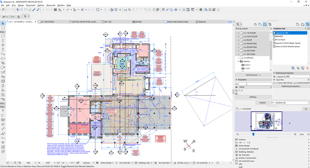

I select the sheets that I want to save to a file in PDF.  I then select the file.  I then click save to file.  the sheets are created but for some reason it does not save to the file.  What might I be doing wrong?  A20 W10 Dell Inspiron Intel core i7
I am not quite sure what you be by "I then click save to file".
You create the layouts you want to see.
You then create a Publisher Set that includes the layouts you want tot publish.
You set the format for each of the 'layouts' to PDF.
You can place them in a folder if you want and you can 'merge' that folder into one PDF file.
You then tell this publisher set to "Save" the files and where to save the files(in Publishing Properties).
Now you 'Publish' that publisher set.
