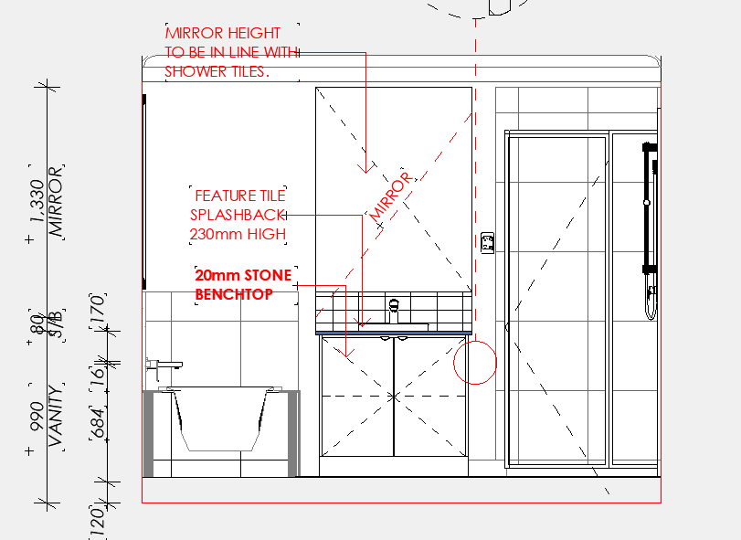

texts and 2d lines on internal elevations on 2nd storey
ahmad525
hey all
question!
i have a double storey house and i changed the storey height on ground floor. on first floor i have couple of internal elevations markers and already drawn with dimensions and notation. what i noticed is after increasing
the texts and lines in RED are the ones that didnt lift up with the 2nd storey after the ceiling height increase of the ground floor.
i know they are 2d lines but i never thought that internal markers dont deal with 2d items as part of a whole.
ive worked on differenet templates before with different companies and i never used to worry about 2d annotations and elements when updating ceiling height or some other stuff.
but now i cant get my head around this and how to fix it.
any help would be appreciated

Andrii Levko
Hi Ahmad.
I think you should use Associative Labels for this.
Other 2D elements are independs from element position or Floor level.
Andrii

Thanks mate.
Its weird because ive worked with other companies and i didnt have this issue.
I needes to change the overlay frame of the srawings as well i think this because there no zoning available but not sure about 2d. I think this had to do with the template setup
