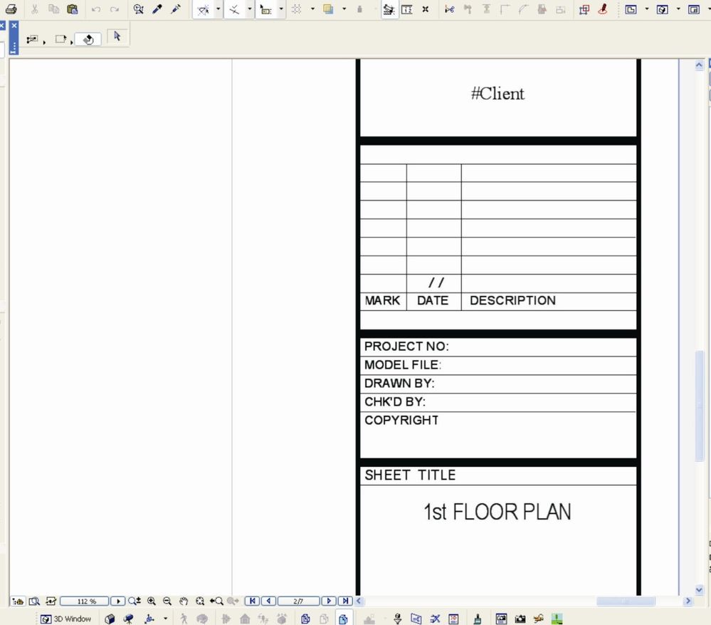

the layout frame
how to fill or change the layout of the frame
I just can fill the layout ID
I wanna change the project no, Drawn by etc.
thank's
in AC 12
2 REPLIES 2
To edit the title block you need to go to the master sheet (at the bottom of the layout list).
or goto..............and change the details and they will auto update.
