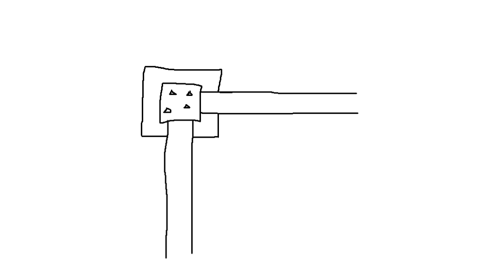

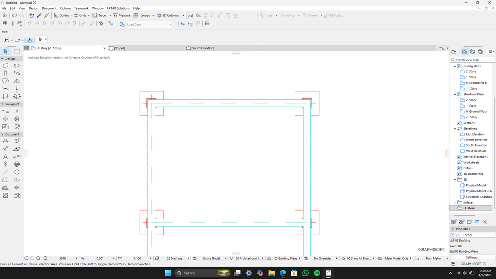

So, for the column (the one with the red line), it has an elevation of up to 6m, whereas the beam’s elevation is only 3m. Now, in that drawing, the beam is resting on top of the column, which has a higher elevation? How is that possible? I’ve checked the building material strength too, and they’re using the same material. Please, I’ve also drawn in Paint what I want to achieve—it’s like that image. So, the largest box is being overlaid by the beam, and the line of the small box is the most prominent; what I mean is that where the beam and column walls meet, the line indicated by the floor plan is the column line.That’s all, please—I’m a decent person

Change the Draw Order of your beams or column. They will intersect in 3D in accordance to their Intersection Priority, but this intersection will not show in 2D...
