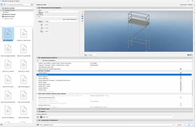

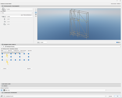

Hi friends,
I went deep on this stuff this afternoon.
I gave cloud the GDL pdf from GS and the manufactur catalog of a Ringlock Scaffolding that i needed. After a few prompts it gave methe XML to make the GSM.
After that, I went deeper and asked for the separated parts.
In the end I've asked for a simplified Ringlock Scaffolding that I could hide parts as I wish. He made me an amazing array to do what i wanted.
This is a game changer for our work.
