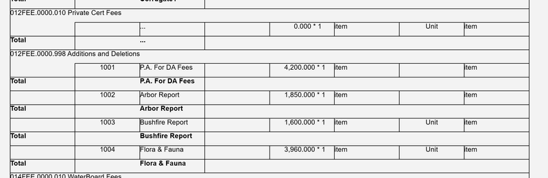

calculations no longer seem to be processed any longer and if you run any of the legacy/component listings etc, what use to work a couple of versions ago, no longer does

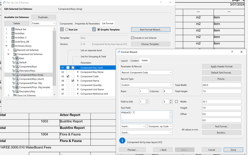

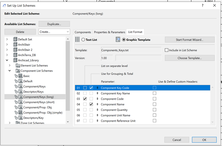

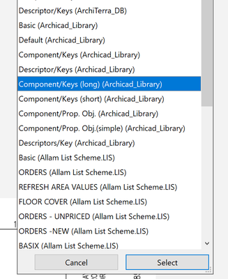

1. Select the standard AC component list as note here
2. After the listing completes, inspect the displayed fields
There are no fields appearing that include any arithmetic expressions.
3. Edit the listing (of course it is built in so it wont save but this is for the purpose of investigation)
4. Create a duplicate of the graphic template and rerun the listing (which will now have a different output but same symptoms

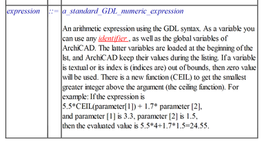

5. Now confirm the issue by editing the current graphic template apply a basic expression to the value of the comp quantity exactly as per the pdf manual
The expression is no longer evaluated but is presented as literal string

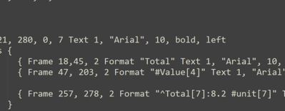

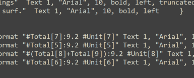

Expressions have to be written in (). Regardless that, this modification with the format wizard doesn't work.
The interesting thing is that there are lists which work with expressions (Rooms, Walls/Stories 2).
When I modify "Components_Keys(short).txt" in the Archicad Library folder, expressions work.

re (); yes that's how I originally did it but even with a simple #(2*3) it just returns a 0 in the listing. This was how all the old listings were done and previously; years ago, worked fine
I'm not using the format wizard (but of course tested using that) but I'm editing the text file externally as it is much faster in dev.
So you are saying that ArhcLib/component/keys/long displays all the fields? Mine definitely does not.

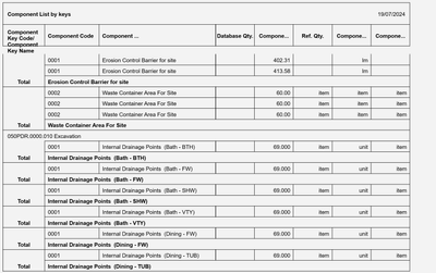

2024-07-19 02:44 AM - edited 2024-07-19 02:50 AM
Thanks Peter, yes that is a room listing...sorry if I wasnt clear but Im not disputing those are faulty.
Even the formatting works perfectly in those
The issue Im having is anything with components.
Those blank fields use format only and it fails
Cheers
