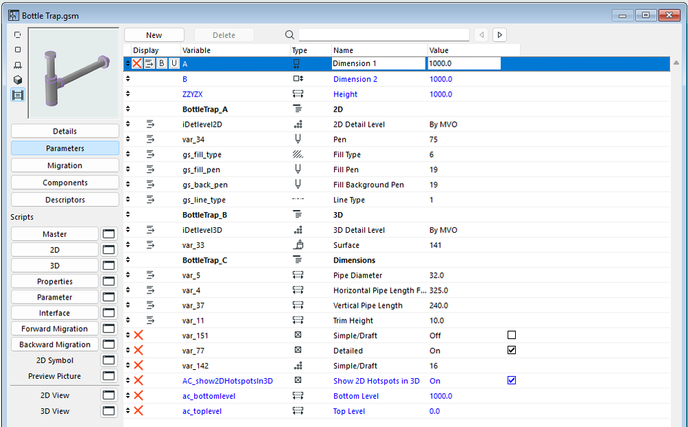

Somehow, our custom-made GDL objects from Archicad 27 can't use the MVO settings in Archicad 29. They were ok in Archicad 25 and 27, but not in 29. Not sure what I need to change in the Master Script and the Parameter Script of these objects to be able to use the MVO 2D and 3D detail levels in Archicad 29. Some of them are made purely with the Library Part Maker 25 - 27, some of them by Param-O 25 - 27, with a little bit of a tweak in the GDL script (Master Script and Parameter Script).

The Master Script looks like this at the moment:
    DETLEVEL_2D_MVO         = 2 !MVO
    DETLEVEL_2D_DETAILED    = 3 !Full
    DETLEVEL_2D_SIMPLE      = 4 !Medium
    DETLEVEL_2D_DRAFT       = 5 !Low
    dim detlevel2D_index[], detlevel2D_desc[]
    iD=1
    detlevel2D_index[iD]=DETLEVEL_2D_MVO        :   detlevel2D_desc[id]= "By MVO"   : iD=iD+1
    detlevel2D_index[iD]=DETLEVEL_2D_DETAILED   :   detlevel2D_desc[id]= "Full"     : iD=iD+1
    detlevel2D_index[iD]=DETLEVEL_2D_SIMPLE     :   detlevel2D_desc[id]= "Medium"   : iD=iD+1
    detlevel2D_index[iD]=DETLEVEL_2D_DRAFT      :   detlevel2D_desc[id]= "Low"      : iD=iD+1

The Parameter Script is this:
values{2} "iDetlevel2D" detlevel2D_index, detlevel2D_desc
values{2} "iDetlevel3D" detlevel3D_index, detlevel3D_desc

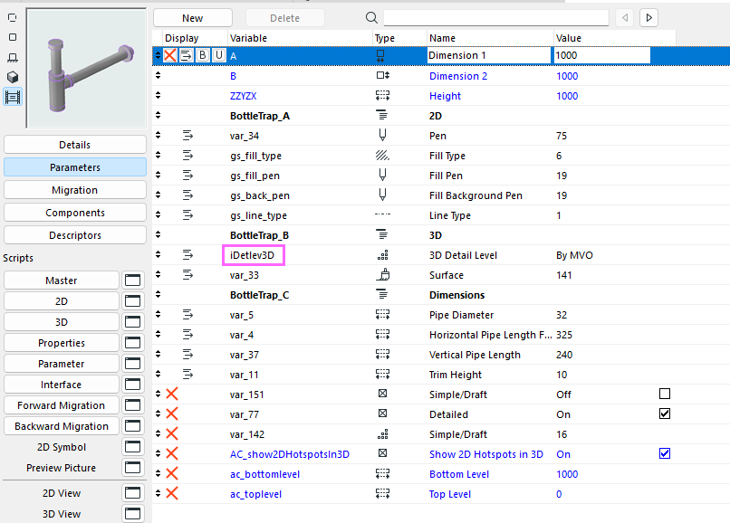

Andras Bognar
I rewatched this video (from BarkingDogBIM) https://www.youtube.com/watch?v=0re8RrU64yo and followed the "crumbs," finding a similar structure in the new MOV Scripts. So, I replaced the old ones with the new ones.
I had to change the iDetlevel3D to iDetlev3D in the Parameters:
The Master Script looks like this now ( changes in BOLD-Italic )

The Parameter Script Looks like this:
values{2} "iDetlev3D" detlevel3D_index, detlevel3D_desc
! Values
    values "var_4" range [0.070,0.325]
    values "var_37" range [0.145,0.240]
This way, I can make new objects in Archicad 29 that work with the new MVO settings.
