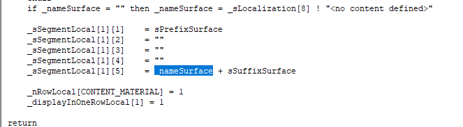

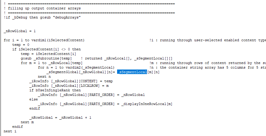

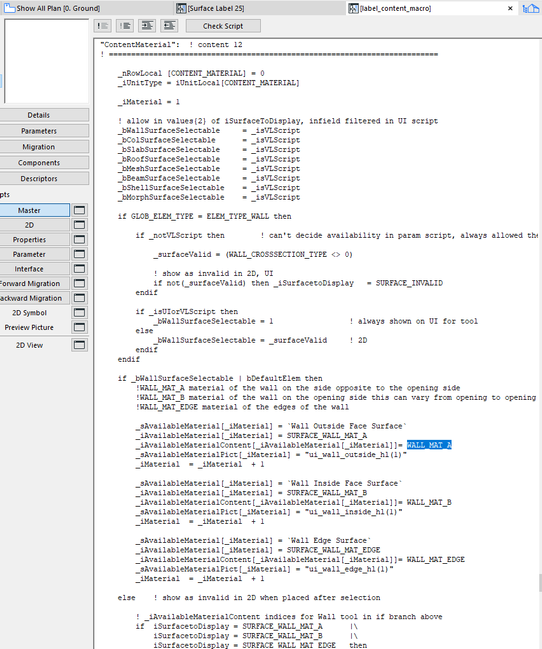

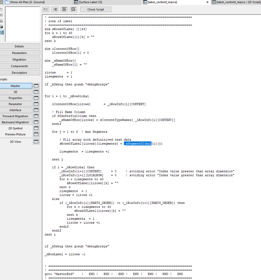

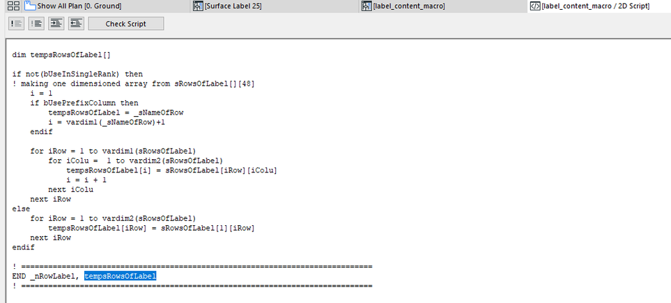

Yes, that is the correct place where the suface is gathered from.
from gdl

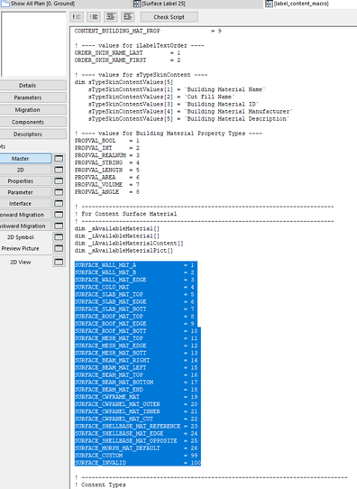

(they are just using a parameter with SURFACE_ in front of the desired gdl code in this list...
from the macro
which then gets the id of the surface
_iAvailableMaterialContent
that then convert's into a name
_nameSurface
which gets assigned to:
_sSegmentLocal
_sSegmentGlobal
sRowsOfLabel
tempsRowsOfLabel
Which gets returned from the macro using the "end returned_parameters" command...
I love the way Graphisoft make this easy to find...
P.S.
it looks like the typed prefex is in array point 1
and the material is in array point 5
using the following in a copy of the surface label
text2 0,1,_sContentStringsHead[1][1]
text2 0,2,_sContentStringsHead[1][5]

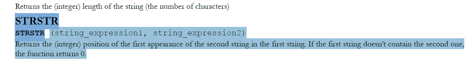

AllanP
i cant find the "CONTAINS " command in the GDL manual
if you use:
if STRSTR(_sContentStringsHead[1][5]),sep) > 0 then
   !!!BODY HERE
endif
I have been using ArchiCAD continually since ArchiCAD 4.5
Member of Architalk since 2003, but missed the migration from Architalk to Graphisoft Communities. Melbourne, Australia
There is no CONTAINS command in GDL (that I am aware of).
STRSTR is what you need to determine if a character is a part of a string.
RHF55
found CONTAINS here https://helpcenter.graphisoft.com/user-guide/137394/
will give STRSTR a try. thanks guys
