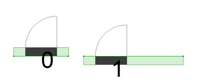

To show you how it works, I selected a standard Archicad door and placed the following code at the end of the master script...
Wall_Is_Flipped = 0
A_Side = "Inside"
B_Side = "Outside"
n_A = REQUEST ("Name_of_material", WALL_MAT_A, name_WALL_MAT_A)
n_B = REQUEST ("Name_of_material", WALL_MAT_B, name_WALL_MAT_B)
if n_A > 0 and n_B > 0 then
   if strstr(name_WALL_MAT_A,"Brick") > 0 then
      A_Side = "Outside"
      B_Side = "Inside"
   endif
   if strstr(name_WALL_MAT_A,"Siding") > 0 then
      A_Side = "Outside"
      B_Side = "Inside"
   endif
   if strstr(name_WALL_MAT_B,"Plasterboard") > 0 and strstr(name_WALL_MAT_A,"Plasterboard") = 0 then
      A_Side = "Outside"
      B_Side = "Inside"
   endif
endif
if   A_Side = "Outside" then
    Wall_Is_Flipped = 1
endif
!   ---- Check with text in plan and in 3D   ------!
text2 0,0,Wall_Is_Flipped
DEFINE STYLE "own" "Gabriola", 180000 / GLOB_SCALE, 1, 0
SET STYLE "own"
text 1,0,Wall_Is_Flipped

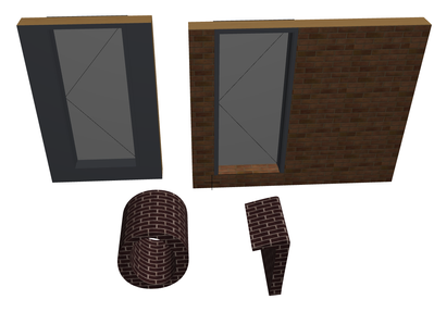

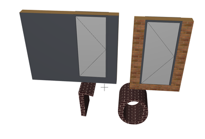

The WALL_MAT_A / WALL_MAT_B are irrelevant in this case. WIDO_REVEAL_SIDE is the relevant value and that changes when you flip a wall. I probably have not test every case, but as far as I have seen my materials and dimensions are correct with every orientation of the opening and flip status of a wall so that would indicate that it is working.

Is there a way to get a surface from the building material obtained with wall_skins_params?
Or do you mean that I have to write code that requires knowledge of the surface of the buildin material like in the code?
AC27 on window 11
Lingwisyer
Guru
If you know the Building Material you can request the surface value of the building material.
