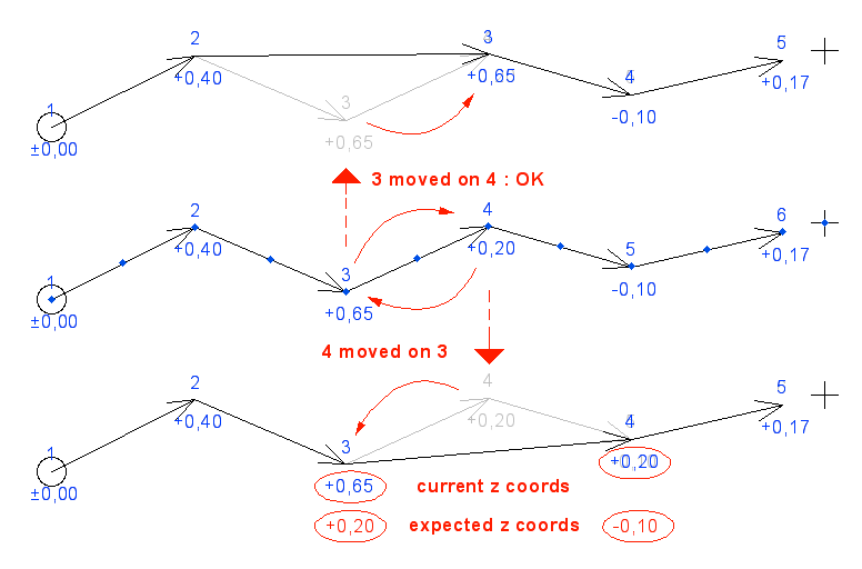

I notice an unexpected behavior with Z coords when removing points. See attached image.
Is it intended to work this way?

I'm aware of the issue. In its current version, for removing points, the script iterates from the first to the last point checking the next segment´s length, and always removes the next segment from the edited point regardless of where it is dropped (previous point or next one). This works OK for X and Y coordinates, but for Z does not, as you point out.
I was trying several approaches to solve that, but I had to move to other things, so I added the Z to that block in the script. It has that small caveat for now: in your example, moving point #4 will remove segment from #4 to #5, thus giving its Z value to point #5 even if you move it to the previous point.
