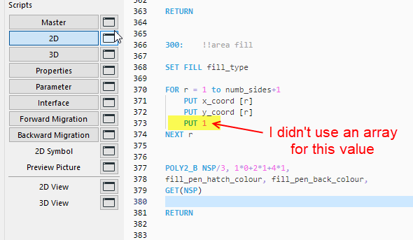

2023-11-14 09:24 AM
If it is always going to be '1' then I would try ...
for i = 1 to points
put xx[i], yy[i], 1
next i
And not worry about setting the array values for s[i]
2023-11-14 09:31 AM - edited 2023-11-14 09:31 AM
