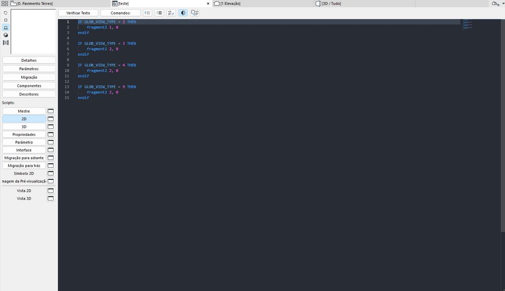

Very cool, everyone! I'm also trying to learn about object creation. Could someone help me? I tried to set a fixed representation — one for the floor plan and another for the elevation/section — but I can't get anything to show up in the elevation or section views at all. Is there something else I need to do? It seemed simple in the posts.
