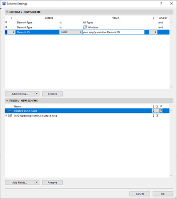

If you create a property for your windows that calculates the surface, you can create a schedule to add these up and exclude the empty window by something simple like element ID.
Not sure if you can easily tie this in to zones if you need to know it on a per room basis.
2022-11-10 02:36 AM
As Erwin mentioned, give you opening an ID of something like "Ignore".
Then it the schedule criteria, you set it up to look for all windows with an ID is not "Ignore".

As Barry pointed out the schedule doesn't have to be any more complex than this:
I forgot that you can grab surface from windows as a field without using properties, since it is already one of the (many) options of data you can grab from windows.
