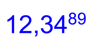

I read door dimension settings from Project Preferences. With Request I get formating string. Now I want create a text as on image below:

Use STR{2} to split the value to normal and extra accuracy parts. DEFINE STYLE{2} has a superscript flag, use that to format the extra part. Put the strings in a
PARAGRAPH - TEXTBLOCK - RICHTEXT2 workflow, so you don't have to worry about positioning.
