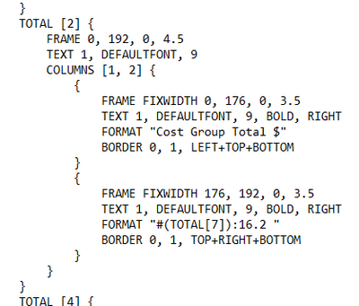

eg I am trying reimplement some legacy quanities etc and the List layout text file no longer works for the listing component listing scheme.
I previously used
FORMAT "#(TOTAL[7]):16.2 " to format output in the layout...now the output is simply 16.2 instead of the formatted value previously displayed...see pic below in (TOTAL[7])
Who would I talk to about what has changed ie why it no longer works...last time was back in v18 I think
EDIT: It seems that it no longer allows maths like this
FORMAT "#(TOTAL[7]/QUANTITY[7]):12.2"

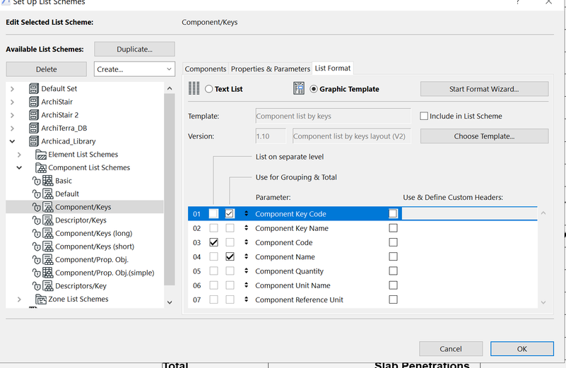

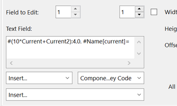

Karl, there def seems to be a bug in it...even just the basic AC27 library listings like eg Components by Keys/Long don't show any fields that have any maths done in the layout
eg Component/Keys
In summary, any field in the listing that is not a simple format
#Value[7] will result in no output shown
