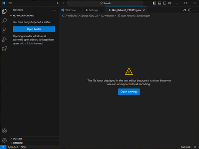

Even when I try to open the gsm file in vscode, it doesn't open.
What should I set up?

LeeJaeYoung
From your article, I am curious whether it is possible to create GDL with visual code.
Even if I install visual code and extension using the method you suggested, I cannot open the gsm file.
I am a person who hopes to create gsm files with visual code. ^^

Miha Nahtigal
You cannot open gsm files with vscode. It can be used with hsf “decompiled” ac objects with possibility to auto compile hsf structure back to gsm.

LeeJaeYoung
I am a beginner.
It seems that it is possible to work in vscode without archicad, but are you saying that you can make something other than gsm and use it in archicad?
I would really appreciate it if you could explain it in more detail.

Peter Baksa
Archicad uses gsm, which is a binary format. The "compile" tool is called LP_XMLConverter, it is installed with Archicad.
There are two formats for source code: XML and HSF. XML contains all in a single file, HSF might be more convenient to work with.
Read about it here:
https://gdl.graphisoft.com/tips-and-tricks/how-to-use-the-lp_xmlconverter-tool
https://gdl.graphisoft.com/tips-and-tricks/hsf-source-format
