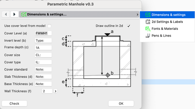

I've almost finished my parametric manhole object (thanks in no small measure to Bruce Walker's fantastic Youtube channel Barking Dog BIM, and Lucas Becker's custom objects) but I have a few things to clean up, the most bizarre one being my custom UI tab icons.
I created some custom tab icons (why not - it's all learning...) which work in the UI, but a couple look like this:
They were all created the same way (with Affinity Photo 2, using GS ones, converted to png) but two of them are green. when edited and previewed, they look fine:
I've tried changing the colour depth to 16bit greyscale and converting to tiff, but they remain, stubbornly - green.

Okay, so there was some weird stuff going on that I don't understand, so I used a GS tab icon as a base, and then created my new icons over it as layers.
The materials and fonts icon was particularly stubborn, and I think there was something about the source file that made it appear green.
I redrew it, and now it's fine.
There was also some weirdness with creating libraries - all down to my ignorance.
What ought to be done now is to embed the graphics into the gsm file, but that seems to be another level of difficulty again. I'll look at that when GS makes the process easier.

I have never encountered this behavior, but now that you say that you started with GS icons it makes somewhat sense to me.
All icons in AC are actually based on an SVG, and for some versions now linking the SVG with the Libpart_XMLConverter (that's how you can put pictures in the objects) will actually create and embed Multi-TIFFs from it. That is some very niche use – AC will then display the right resolution based on your screens resolution.
These Multi-TIFFs are so rare and wildly unused, that the support for it is quite low on the editing software side. Photoshop can open these, but not save them (as far I remember). So it might have scrambled up there something while you did your edits.
