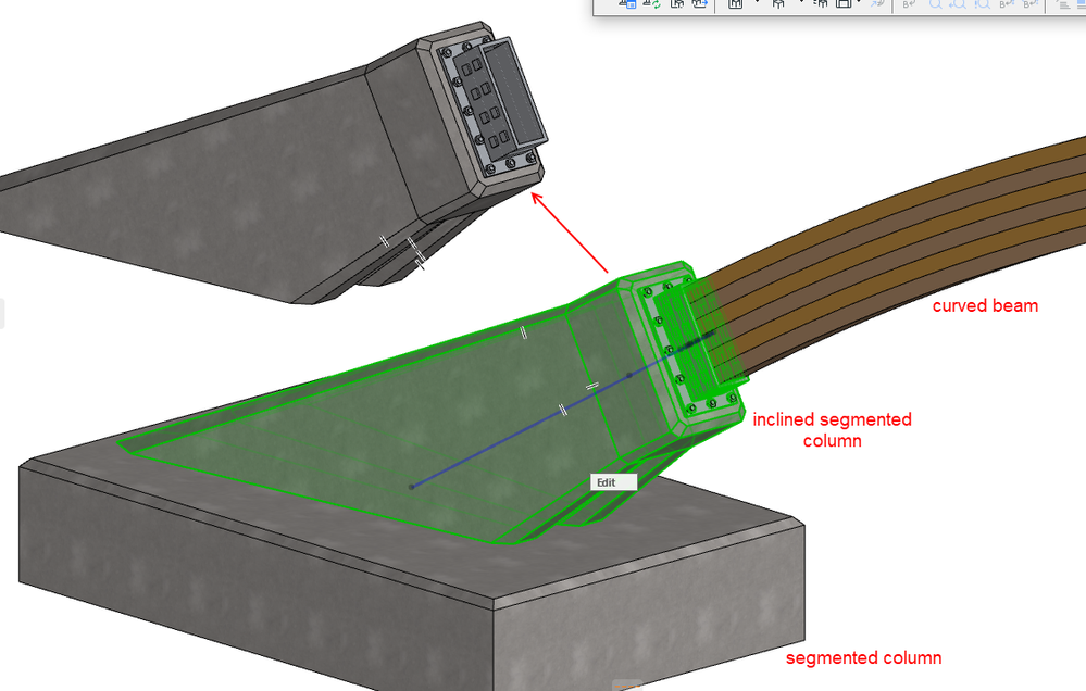

I created a precast column with GDL. Archicad sees it as an object, not as a column, because it is made via GDL.
Normally when a column passes through a slab, Archicad creates a gap in the slab according to the order of priority, but when it comes to an object, I have to create all these gaps manually in order not to get a conflict error. Is there any way to automatically cut objects as well?

Objects do not take part in automatic Priority Based Connections.
You must perform a Solid Element Operation.

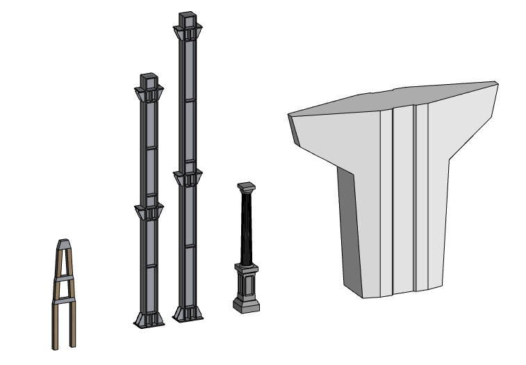

However that column could be created as a segmented column, and if complex profiles are used for the segments, they can also have profile modifiers that can allow for some on screen adjustments.

But this is a simple version of column. There's no way I can do this with the column tool. I guess I have to SEO the model every time.
You can do some pretty amazing columns with a segmented column.

Archicad segmented columns are great, but the real trick of this column is the oblique consoles. Firstly, I tried to do this by creating a custom profile, but I could not find a way to create oblique consoles that are not symmetrical or overlapping at close heights. So I created an object via gdl.
27
That would be difficult, as you would need overlapping segments for the different console heights.
GDL is a good way to go.
