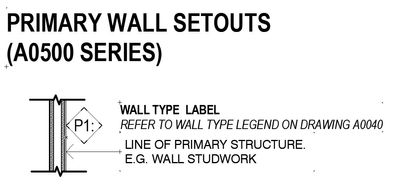

Hi Team,
I am trying to create a tag for our Wall Types for our office. We have an existing tag, but are looking to overhaul our template, and are now including some extra information in the title of our wall types. As a result, the label now pulls the extra ' : ', which we are hoping to avoid, only showing the text string previous to the ':'.
I have limited knowledge of GDL, only really extending to copying what already exists! I've done some research, and had a play with that I've learnt, but still can't get the label to show correctly.
Can someone point me in the right direction (code attached below)?
Thanks!

I am assuming your wall composite name is something like...  P1: extra_description_here
I think it is because you are doing the string search (STRSTR) for a space " " after the colon instead of the colon ":" itself.
So the number of characters you are returning to tex1num is one more than the colon.
You are then using that string position number to get the substrings (STRSUB) from the composite name.
So search for the colon and/or adjust the number of characters you are using in the STRSUBs
I may be wrong, but that is my hunch.
drewcaddy
Thanks Barry! That worked a treat!
This may be a stretch, but would it be the same for a surface label too? Hoping to do the same with the standard AC Surface Label, but can't see a similar code to what we had in the Wall Tag to make the update. Hoping to achieve this:
I really don't know for sure.
It looks like the surface label CALLs macros to gather and arrange the information.
Peter Baksa
Hi, I don't recommend modifying the AC Surface Label, it's too general for your task,
if you are only labelling wall composites.
Use WALL_COMPS_NAME to get the composite name, then use the STR functions to take it apart.
