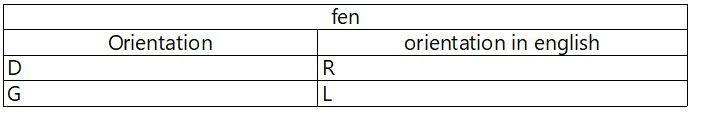

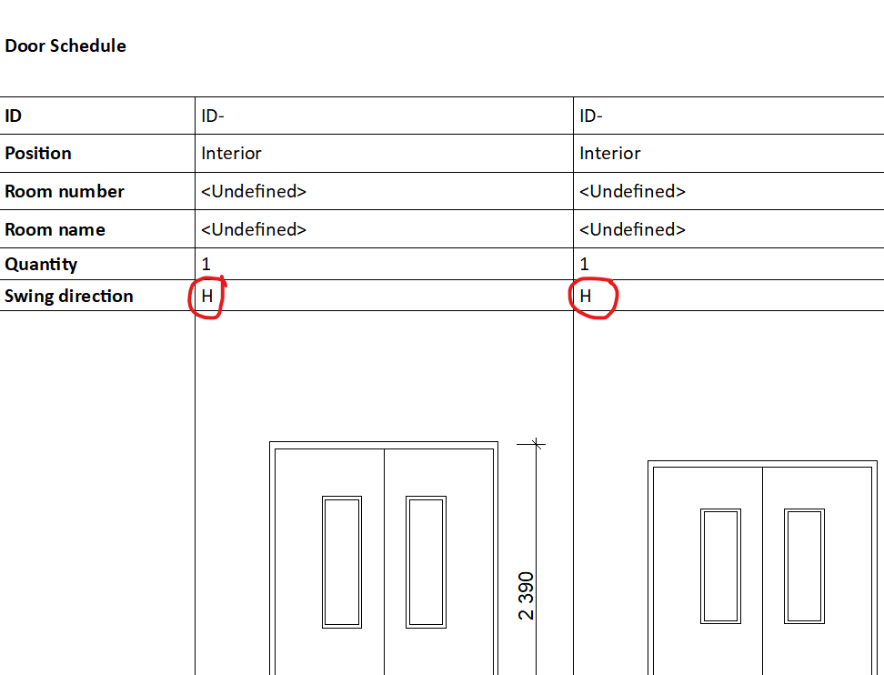

Hei everyone,
I am working on the AC25 norwegian version and I would like to change the swing direction text on doors.
Swing direction in norwegian is H (høyre = right) or V (venstre = left). How can I change this text from H-V to the english R-L?

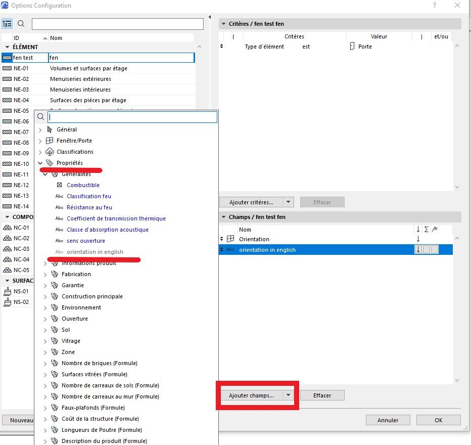

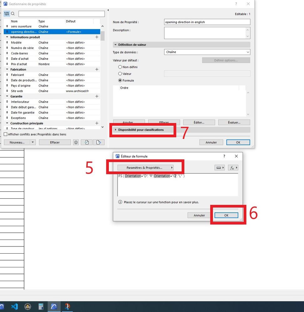

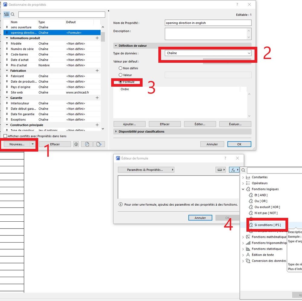

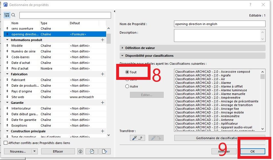

Go to options>property manager and create a new rule that is a string with a formula:
at step 5 chose the orientation parameter you selected in your schedule and edit the formula by replacing D by H and G by V.

Thanks a lot for your detailed description Julien. I think this is the way to go to avoid changing the object in the BIMCloud library that everyone at the office uses.
