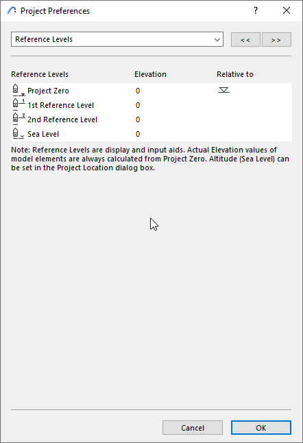

2023-12-07 04:52 PM
thank you so much. ^^
But what I don't understand is that elev4 is a negative number.
I set 12.5, but the answer I get is -12.5, which is perplexing.
2023-12-07 04:59 PM
Sea Level is tricky. When you enter it in the Project Location settings, you enter the height your project 0.00 is from the sea.
So, if the project zero (ground floor 0.00) is 500 m above the sea, you enter "500 m". But then when you enter the "Project Preferences > Reference Levels" settings, your origin/base level is the ground floor 0.00 level, and the other reference levels are measured from there. so if you open this dialog, you will see that the sea level is a negative number here (because 0.00 is ground floor, and the sea is 500 m below this level, in other words: -500 m).
Long story short: In the Project Location settings you have to enter it as a positive number, but other than that, it is always negative (as long as the building is above sea level of course).

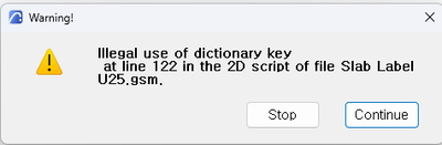

I would be grateful if you could tell me the object containing the code that I can study.
I didn't tell you the value of this.
text2 0,-3,Builtin.General_ElevationToSeaLevel
