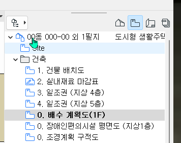

I want the floor plan names to be readable in GDL.
I drew a drawing called a facility layout for the disabled
I thought that if I could read the names of the planes, I could use GDL more diversely.
I heard that I could read it before, but why did it disappear...
I'm wondering if making it readable again would be a problem.
If you can read it, please let me know.
How can I figure out the various types of this drawing in GDL?
1. This is the same ground floor plan.
AC27 on window 11

The "STORY_INFO" request? Or are you talking about section planes?

Sorry the image is in Korean.
I make several floor plans from the ground floor plan.
The letters of GDL were visible and invisible. If the shape of the line appears, etc.
I want to read the name of the view, but it says no.

Oh. You want the View name. As far as I know, that is only available for Title objects... Objects within the View cannot reference it.
