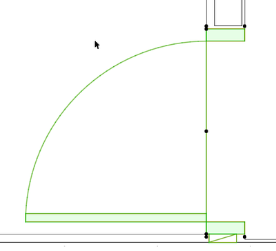

I want to turn off the hotspot 2 in the wallhole that I don't see on the door.
LeeJaeYoung
In the figure below
The unit hotspot2 is what I put in, but the wallhole's hotspot2 is not what I expressed.
In the figure below
AC27 on window 11
1 REPLY 1
Peter Baksa
Hi, automatic hotspots can be disabled using ac_hole_hotspot_control parameter.
