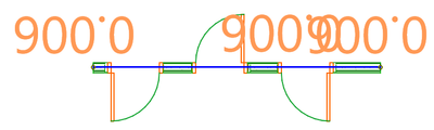

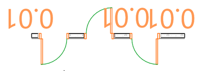

Is the master and 2D script not working in the invert wall direction?
dim skinCummThkRef[]
cumRefThk = 0
if bCompositeWall then
     for i=1 to WALL_SKINS_NUMBER
          idx = i: gosub 10 ! Get proper index
          skinCummThkRef[i] = WALL_SKINS_PARAMS[idx][SKIN_THICKNESS]
     next i
endif
text2 0,0, skinCummThkRef[1]
Moving a wall changes it
Why does this happen?
It changes immediately on the flip wall, so there seems to be no problem. Is the master and 2D script not working in the invert wall direction?
This is the outermost wall thickness.
If you do an invert wall, it will be the wall thickness inside.
AC27 on window 11
You need to write a small equation that reads the wall parameters backwards if the wall is flipped for your go sub 10

However, in the question, if I invert wall, the inner value (60) comes out.
this code is in Cavityclosure.
[Master Script]
reorder = (AC_Wall_Direction_Type <> 1 & AC_Wall_Direction_Type <> 3)
10:
    if reorder then
        idx = WALL_SKINS_NUMBER + 1 - idx
    endif
return
Again, I don't know if this routine worked or not, but suddenly it has a value of 60. Then, the value should be maintained, but if you move the wall again, the value changes to 10.
I don't understand this. ㅠㅠ
When flipping the wall, keep the value of 10.
The problem is that this only happens on the invert wall.

Peter Baksa
Yes, WALL_FLIPPED. You can read more here about the orientation of openings.
The master and 2D script should work the same, but only if you don't store parameters in the master script. Then master script runs also before parameter script, and some globals might not be available in parameter script context, or the parameter script might not run when the wall is flipped.
