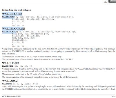

it is a GDL command.
you do not have access to the source code, GDL is a higher language where source code of the built in functions are not available.
the parameters and description are available in the GDL Manual
https://gdl.graphisoft.com/reference-guide/doors-and-windows#WALLBLOCK22_gdlcommand

The manual in English is too hard to understand.
So, it would be very helpful if there were sample codes, but the GDL manual doesn't have many example codes. So I have to go looking for it, but it's a very sad fact that I can't search in the source code even now in the AI era.
