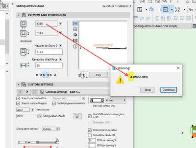

I want to know the name of the parameter variable in the parameter script easily.
I want to know the name of the parameter variable in the parameter script easily. Is there any easy way to find it?
Right now I want to know the name of the image above.

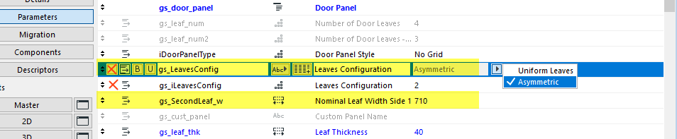

I had a poke around and I couldn't find the 'Shape' page in the maze of macros.
Just scanning through the parameter list in the door object itself I could see these.
They are the ones you show in your image.

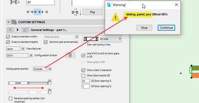

I just tried and it seems to work best in Parameter script.
Master script is run more often so you will get more messages.
Doesn't work in the 2D/3D script.
Also with width and height you have to open the object settings and adjust parameters there because that is where you adjust other parameters.
Doesn't work with changes you make in the info box.

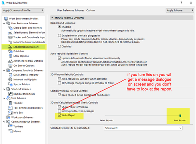

Also in your Work Environment, make sure you have 'Write Report' turned on and maybe set it to full report.

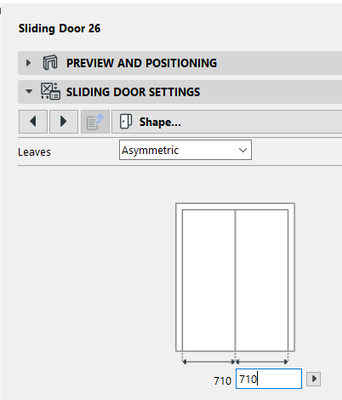

The only suggestion I have is to open the script for the door.
Look at the Interface script.
You may have to open some of the door macros to find it as Graphisoft like to CALL macros in their doors and windows.
Once you have found the interface script, you will need to find the page for 'Shape'.
Then you should be able to see the parameter names they use.

This is the only `Shape` item. How do I find it?
Should I just give up on finding parameters and just create and use them? ^^

Peter Baksa
One way to find it relatively quick is writing print GLOB_MODPAR_NAME at the start of the object, save it, change the parameter on the ui, and check the session report window.

Just type... PRINT GLOB_MODPAR_NAME ... at the beginning of the script.
Amend the parameter in your placed object.
Then FILE menu > Info > Session Report to see the name of the parameter you just changed.
If you are using the default Graphisoft library, you will have to 'Save As' a new object after you have edited the script.
Then place that new object to test.
Then you can simply discard that object when you have finished with it.
