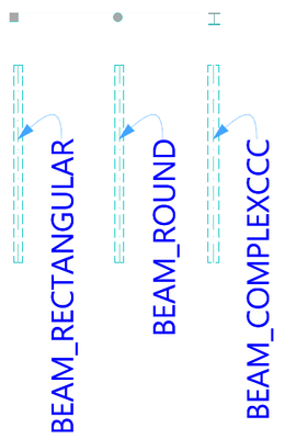

taigd
It works...
IF GLOB_ELEM_TYPE = 12 or GLOB_ELEM_TYPE = 28 THEN
     IF BEAM_SEGMENT_INFO.segments[1].crossSection.type= 1 THEN text2 0, 0, "BEAM_RECTANGULAR"
     IF BEAM_SEGMENT_INFO.segments[1].crossSection.type= 2 THEN text2 0, 0, "BEAM_ROUND"
     IF BEAM_SEGMENT_INFO.segments[1].crossSection.type= 3 THEN text2 0, 0, "BEAM_COMPLEXCCC"
ENDIF
