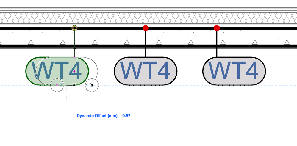

Hi All
I have created a label that extracts data from Walls. When placed, it is positioned parallel to the Wall. I have used a Request statement to get the width of the relevant data text to create a 'pill-shaped' frame (incl. fill). This label also has a custom leader that points to the element (Archicad's Pointer is not used). This is all working well. What I would like to do (something I'm struggling with and seeking help on) is to be able to dynamically move the 'pill-shaped' frame to three different fixed positions along a single axis (parallel with the Wall). I have already coded a dynamic hotspot to run along this axis, and the 'pill-shaped' frame runs along with no problem, but it is infinite. I want it to be fixed to three positions. Refer to the attached image for where I would like the positions fixed. From my exploration and testing, I can't get the text width into the Parameter script (where I'm trying to fix these positions with a Value statement). FYI my Value statement looks like VALUES "dynamicOffset1m" RANGE [-0.0015,0.0015] STEP 0, 0.0015. I'd like to replace the '0.0015' with text width calculations. Does anyone know how to achieve this? Thanks in advance!
Thanks
Brendon

A workaround is to give graphical feedback in GLOB_FEEDBACK_MODE. Then the hotspot doesn't have to have a limit, but you still can give hint about the separate options. An editable hotspot can be drawn at a fixed position x: hotspot2 x, 0, unID, editedParam...

Thanks Peter - I knew you would have something to share! And thanks everyone for your comments, they are all much appreciated! While I don't have a perfect solution ('by design' for a good reason), I think Peter's use of GLOB_FEEDBACK_MODE (which I never used before) and having fixed hotspots (which can be driven by the text width are great in combination. Refer to attached image. It would be great if Hotspots could be seen only when GLOB_FEEDBACK_MODE = 1 though (unless of course I am missing something)!

I think I have managed to come up with a solution thanks to Peter's comment. Peter gave me an idea which seemed to have worked. Although I didn't use GLOB_FEEDBACK_MODE, I used a variable in the 2D Script that forces the hotspots to not exceed the beginning of your curve via an if statement. I have attached the file.
Cheers,
Shaun.
Brendon Reid
Hi Shaun
Although my Label works the opposite (my 'pill' moves, not the leader), the functionality provides an even better result! And such a simple way to do it! Thanks for this; much appreciated!

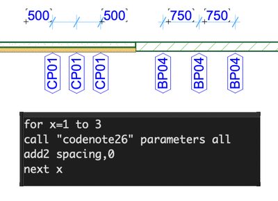

Hi Brendon
Doing in the label seems tricky so I made a new label and called the code label as shown in the script.
it needs a directional rotation (for the wall direction) and a moveable hotspot but that shouldn't be difficult.
Just a thought.....
Hope this helps
