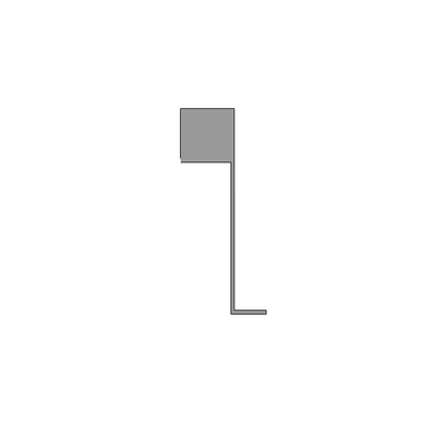

Yes I'm using it with the railing tool but rotating it won't work. Among other things, I want it to be customisable using MVO, and be smart enough to know when it's at the start of the railing and when it's at the end without me having to manually edit individual elements of the railing
Here is the profile in plan:
You see rotating it wouldn't work. It would need to be mirrored. I managed to use a workaround with MUL -1 if the railing sub-element has a specific ID but I would like it to be more automatic than that.

RAILINGEND_DIRECTION_AND_ANGLE is not applicable to posts.
The post's origin is always (0,0,0). Currently there is no data available to support this idea.
